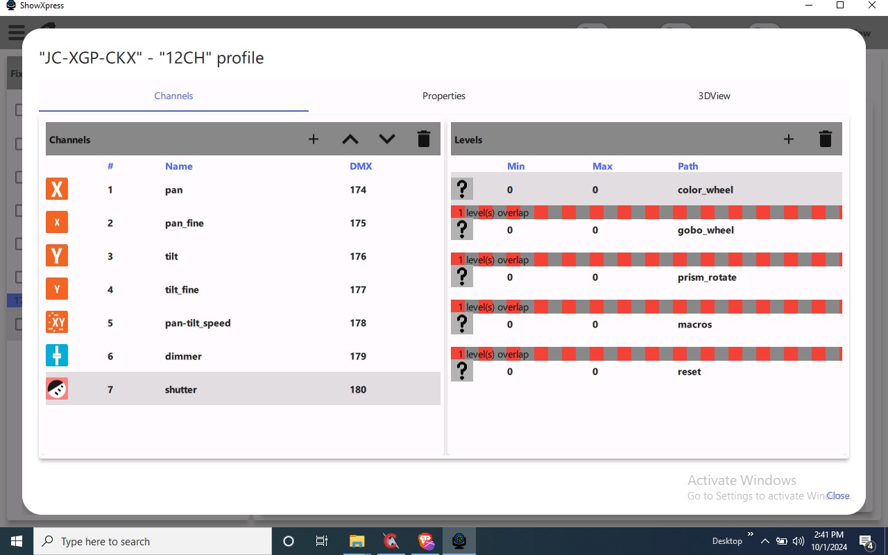

The following XMl I created for a light but within LC2 it only shows to CH 7 - Shutter. Then within that it suedo list the rest of the channels.
I did attempt to set a level for shutter and close it. But that didnt change anything.
So what is wrong with the following XML?

So I have gotten it sorted.
It seems you must restart LC2 every time you make a change to the XML file. I was assuming that loading for "External" would force update but it wasnt.
The other portion of my fix was to add 2 levels to my shutter
Code: Select all
      <Channel name="shutter" path="shutter/">
        <Level end="1" name="closed" start="0"/>
        <Level end="255" name="open" start="2"/>
      </Channel>
Which doesn't make since. It should allow just the single line. Like dimmer ...

The channel "shutter" is supposed to have at least the levels "closed" and "open".
It has sometimes the level "dimmer", but in your case the function "dimmer" is in a separate channel.
Here is the revised profile.
There is still a problem with the channel 'gobo'. We suspect some levels are gobos with shake effect, but we can not check without the manual.
We suggest you to edit our file and yours to watch the differences.
