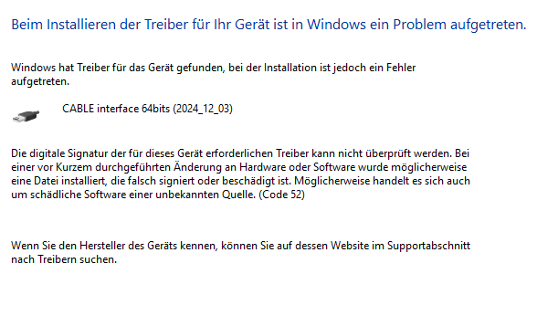

Hi, I tried to install the drivers for the newest version of the software and couldn’t get further than this error:
Screenshot 2025-05-27 171925.png (18.32 KiB) Viewed 52452 times

Please tell us the details of the Operating System and the processor (Windows 10 / 11, 32bits / 64bits, Intel / other).
And we will check that.

Thanks for the fast response! I have a Windows 11 machine with an Intel i7-14700K and an RTX 4070 Ti. Is that everything needed?

Thank you for these details.
We're talking to Microsoft to find out if they've recently added a new security feature in addition to the digital signature.
Every time we send them a message, they take between 3 and 5 working days to reply :-(
So it may take a while.
