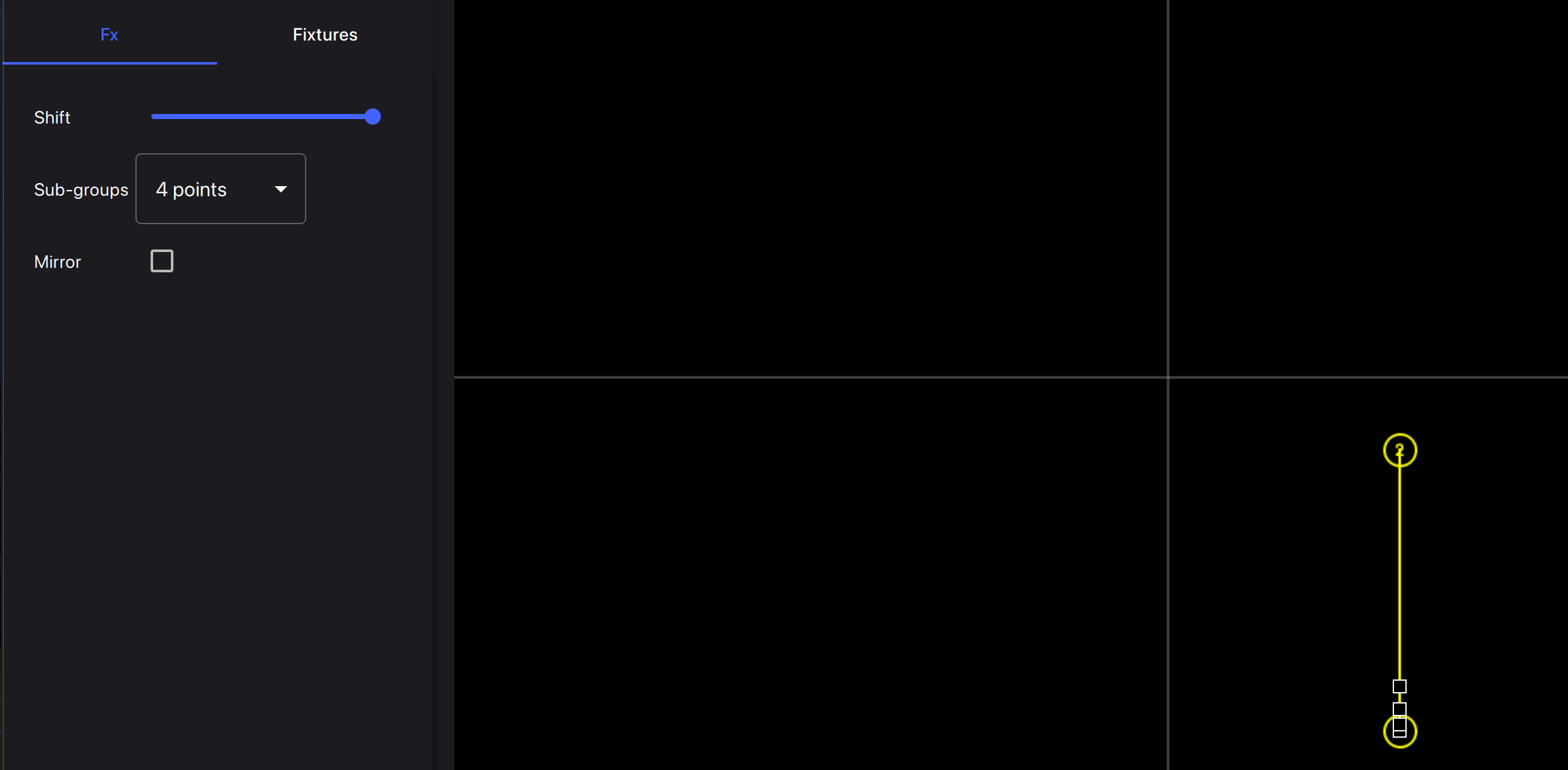

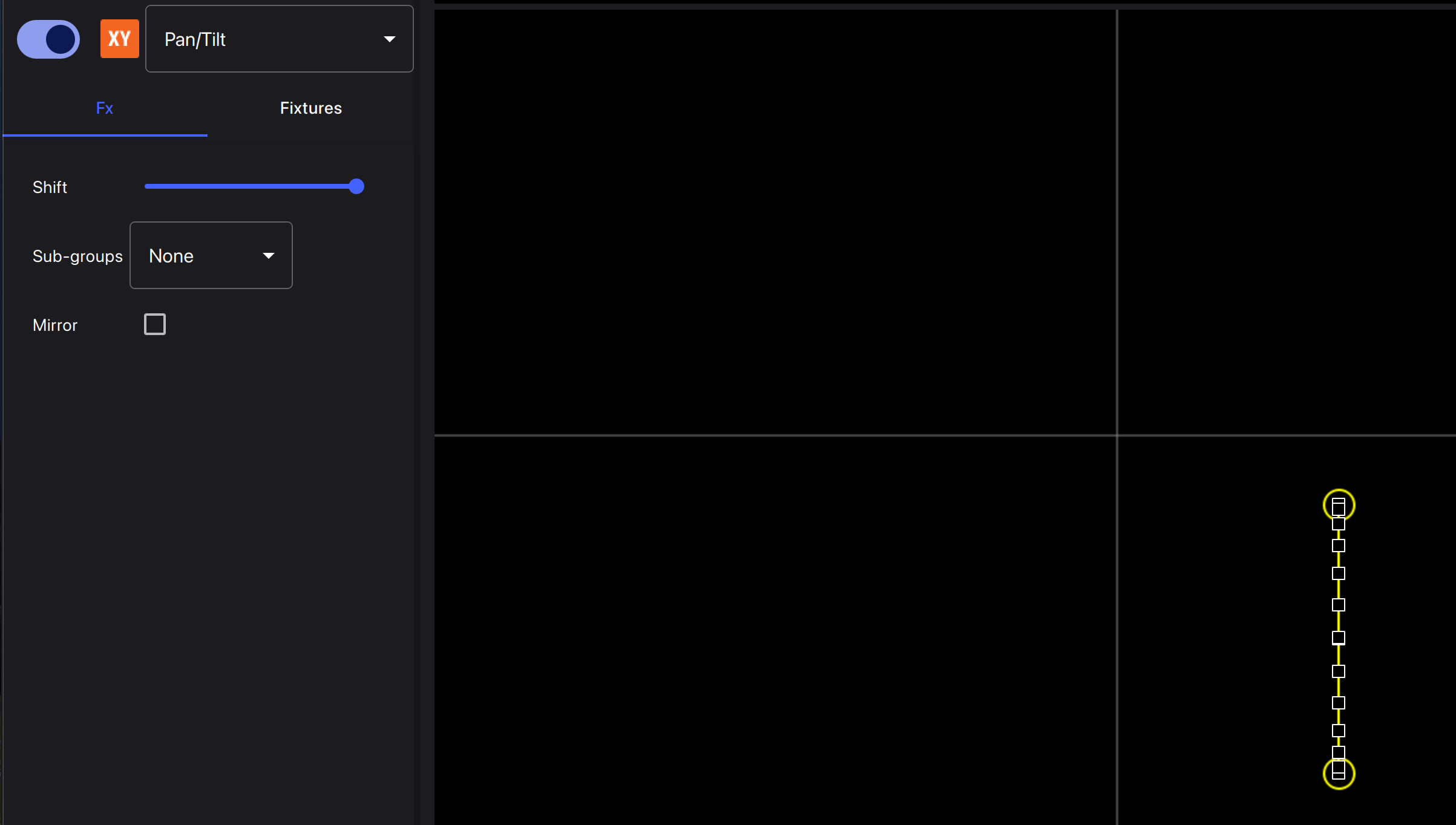

When using the shift slider (value 100%), the fixtures nicely space themselves between the points. But when using the sub-grouping options, you can't get the fixtures to fully spread between all points. See screenshots. Is this intentional or could this be fixed?

With points I mean the yellow dots (1 & 2 in screenshot), not the squares. I kinda expect when setting the slider to full, the squares are fully spread between the yellow dots. I even expect it to spread between 1, 2 and back to 1 again so there is a fully continues loop.

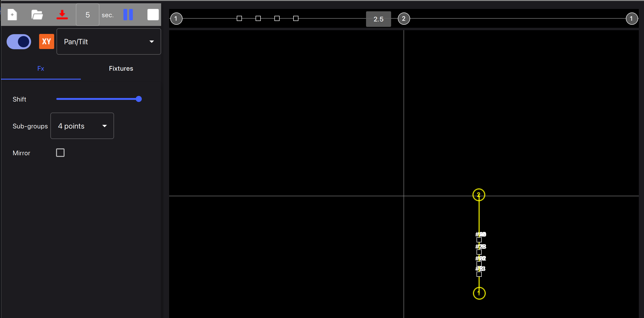

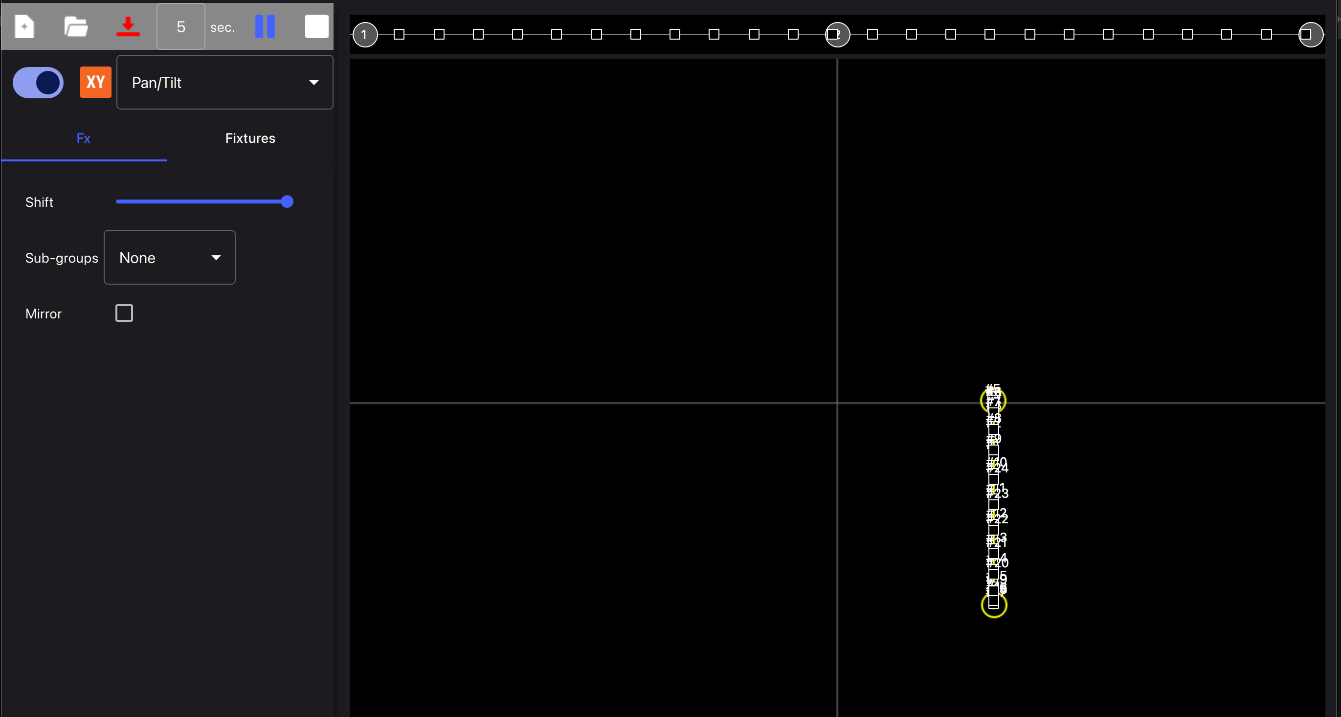

I think you misunderstood me. I not want to create a static effect. I want to create a dynamic effect where the pan/tilt is moving in lets say 4 subgroups. I would expect that the 4 subgroups are evenly spread when setting the shift slider to full, just as when u don't use subgroups - they are evenly spread (a whole loop p1 > p2 > p1) see screenshot 2.
The subgroups are grouped together, see screenshot 1.You see at the top that there are 4 squares almost together. I would expect with a full shift slider, they are just as spread as the screenshot 2.
Hope this makes sense to you
