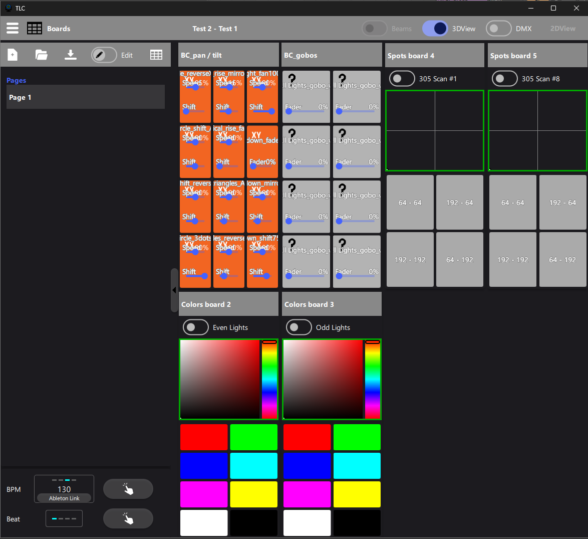

I am having a challenge seing the 3d view window. Running Windows on a PC.
I have everything set up as per the turorial, I am not in edit mode, I even reinstalled teh app and started again.
Am stuck now. any help would be great

Re: No 3D View
Thanks for the reply
here is the screen shot and the show files
- Test 2.zip
- (31.08 KiB) Downloaded 1372 times
Re: No 3D View
There was some errors in the profile.
Please replace it by the attached one (in the folder "../LightShows/YourLightshow/fixtures/"), and re-do the "lightshow creator" process.
