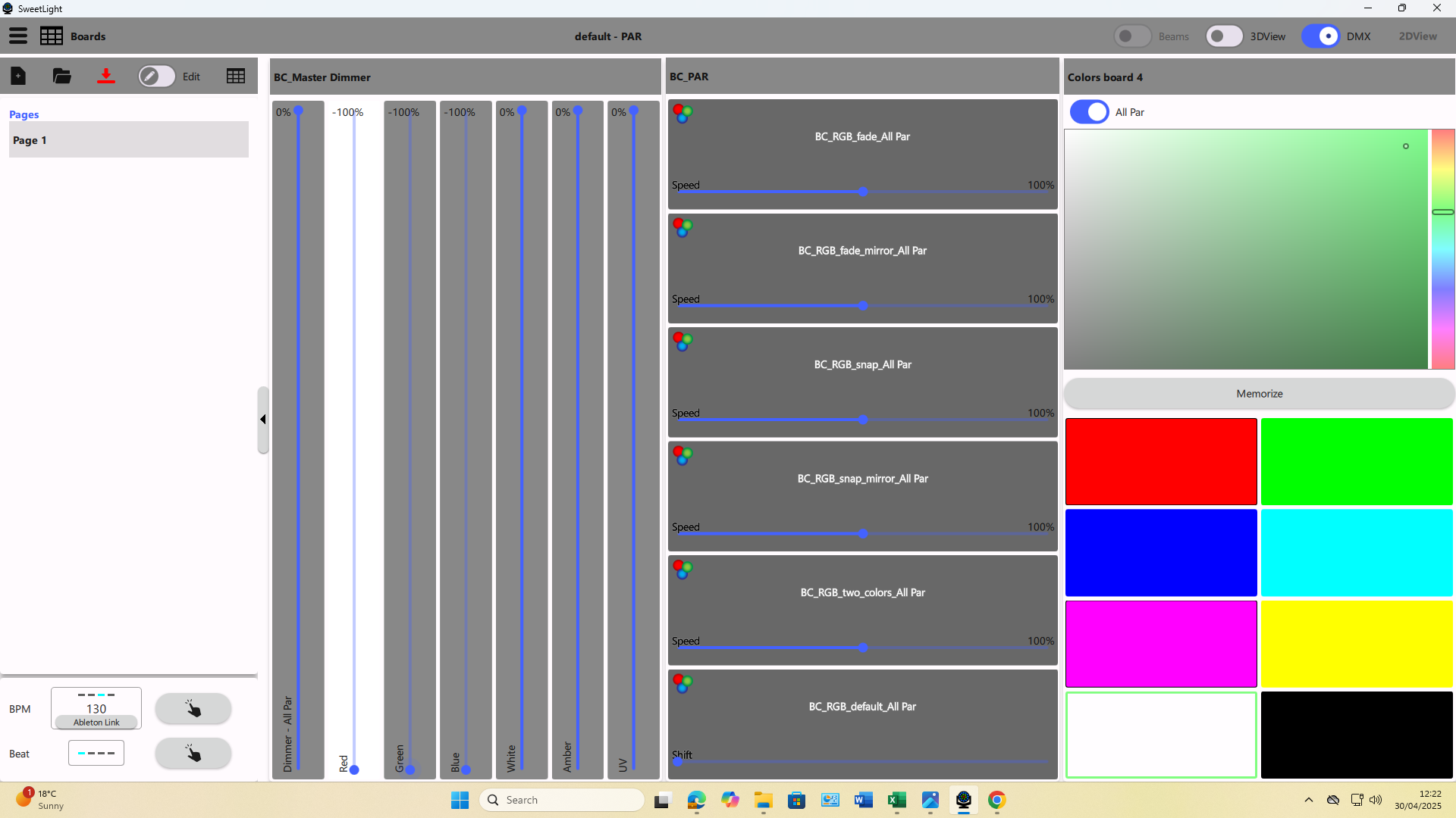

If I am using a PAR fixture with other colours other than RGB, can these be controlled in the boards screen? ie my fixture has a UV channel.
I have tried setting up fader board, but i can only ever get control of RGB.

Hi,
I can see you can select the channels for faders. But in the board screen i can only control RGB, i can only control RGB when Colour board is turned on.
But cannot seem to control white\UV/Amber channels on the faders.
See my screen shot, I have a fader for All channels and faders for red, green, blue, white, amber, UV.
But i cannot control white, amber and UV. Only RGB when Colour board is turn on.

The "Master Faders" act proportionnaly over the current level given by other buttons.
You have to create a scene where the channel is on.
Then the Master Fader will act on it from -100% to -0%.
